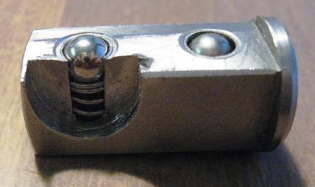

I am wondering how many of us have ratchets missing the plugs? I have a number of them and I am in the process of making a generic replacement plug (hardened and 100% functional) . Would this be on interest to any body else?

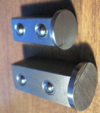

These are not "there" yet, but I posted 2 photos (edited the first posting) - One is a 1/2 plug and he other a 5/8 drive. I will also make a few of the 7/8 plugs. As for cost - I don't know yet, but the target is under $20.
These don't "exist" yet. There are 4 total, they are not hardened and the design - prototyping is complete. This week they go through hardening. I asked how hard they will be and the answer was interesting - "harder than a witch's heart". I think the real answer will be Rockwell 62 or 65. Harder than the 1920s plugs.
These are not copies - the ball detent is different and the manufacturing is totally different. Snap on used some heavy duty presses to create the impression that held the ball in place. They seemed to be changing these methods, the diameters, how many balls and how they were stamped. These use harder balls, better springs and different diameters. The originals used soft balls and many show a flat side - these replacements should resist this
It should be a good generic and usable replacement part for Snap on, craftsman, proto and many others. It will not fool anybody who knows what they are looking at - Too clean, too hard, no oxidation, better ball detent.

I just got in the plugs from the machine shop. They look really good. I have 3/8, 1/2 and 5/8 plugs. I don't have the costs for the 1/2 or 5/8, the the 3/8 are $12/each. If you are interested - let me know.
