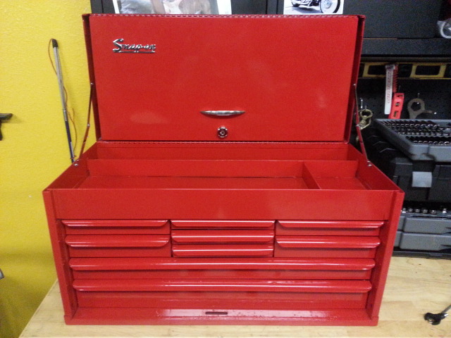

I completed restoring my KRA58B. Its a 1964 model. This was my father in laws tool box who passed away 2 years ago, that my wife wanted to keep for our son. Im glad she did. I regret not taking before pictures, but it was in shambles. It was dented all over, top didnt close all the way, both cover stops were bent way out of shape and one was even broken, a couple of holes drilled in the front cover. It was missing the handle, thank you very much to macother for helping me out with the replacement! The entire box was rattle canned geeen over the original red and some of the drawers had silver paint on top of that.
Because this is a family heirloom I put a little extra into it. I had the entire box powdercoated includng the drawer slides. I straightened out the cover stops and welded the broken one back together. I welded the holes closed. I replaced the lock with a modern one. I chromed the locking cam, bars, and cover stops and rechromed the Snap On emblem. I used stainless steel tubular rivets with the heads polished to put the cover stops and locking mechanism back together.
There are still dents in the box and you can see pitting from the rust on the bottom of the boxn which adds character to it. Im very happy with how it turned out. This box has held up well for the abuse its seen for 50 years. I'm planning on it lasting for at least another 50.
