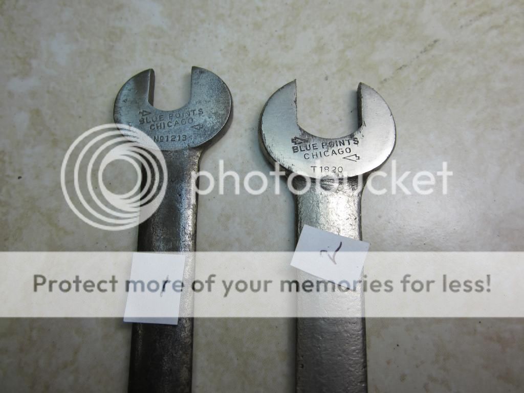

Wrench no. 1: Blue Points name stamped into head with Chicago under BP, has arrows. model number reads No1213 (only made pre 27) This does not have the T in it, but this is may be a error, due to the four digit being in conflict with the reg. wrenches.
Wrench no. 2: Blue Points name in head. Model number has a T. These two would probably date 22-26.

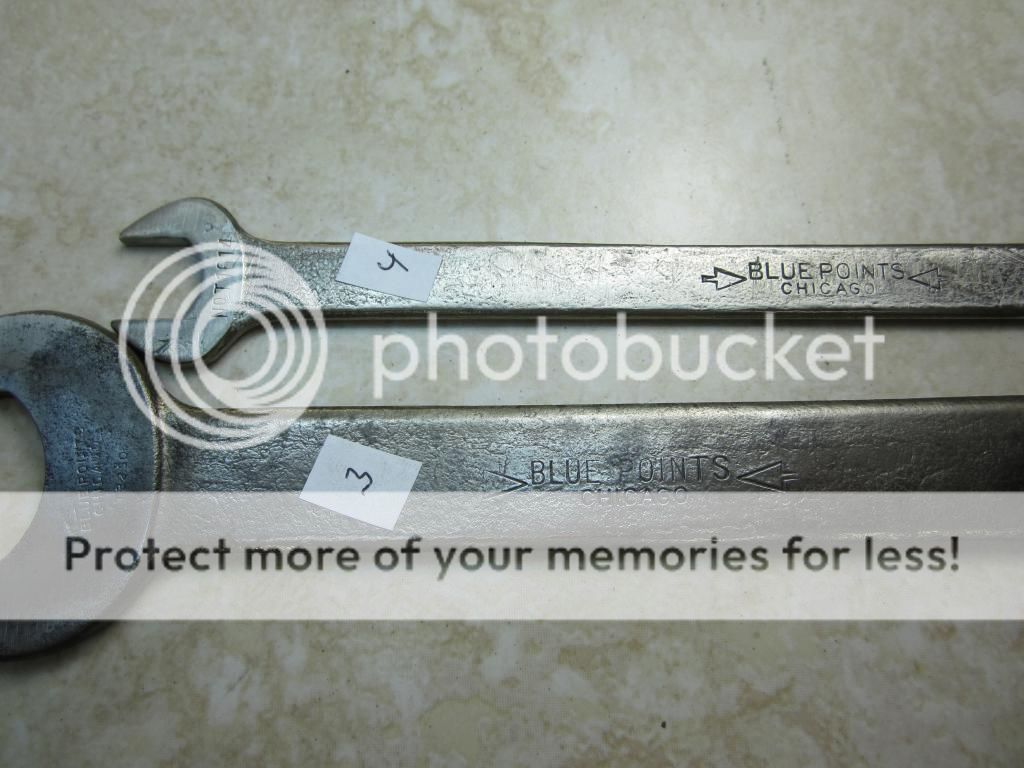

Wrench no. 3. Blue Points name in head and in the body. Notice that Chicago is below the Blue Points name in the body.
Wrench no. 4. Blue Points name is only in the body. Chicago is still below the name. Model number starts with No these probably would date 26-28

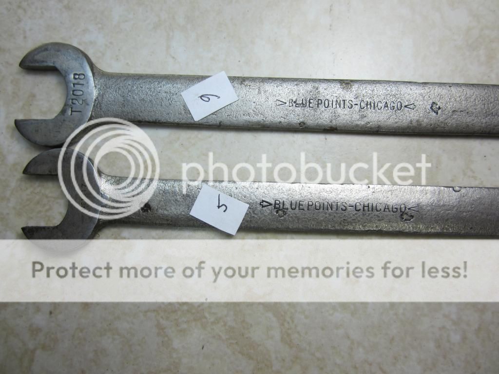

Wrench no. 5. Name in body, but the Chicago has been moved to the right of Blue Points. Font is much smaller. The model number font is small, also this one has no T. (this may be a error, or just different makers. (another story)
Wrench no. 6. Name in body, Chicago on right. Model number font is much larger, also has the T. These probably date 27-29

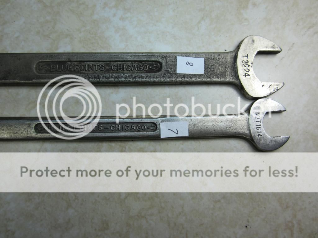

Wrench no. 7. Name is inset into the body. Model number starts with No
Wrench no. 8. Name is inset into body. Font is a little bigger than 7. model number starts with a T. These are probably 29-30

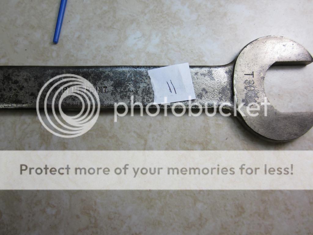

Wrench no 11 The oddball. just Blue Point, model number is not listed in 31-33. I have no clue.
