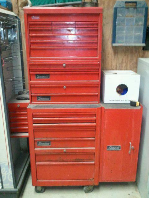

I have a set of snap-on tool boxes that have been setting in a closed in barn for years! I'm going to try to clean them up the best I can, or get them repainted. I'm thinking about getting estimates from body shops and I need a paint color code. Does any one know a snap on color code,or is it worth the investment to get the boxes repainted. I purchased the set new in 1982. Roll cab 7 drawer# KRA380/side cabinet# KR274A/ 2 drawer section# KRA428B/ 3 drawer section# KRA429B/ top chest 9 drawer# KRA59E.

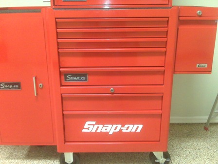

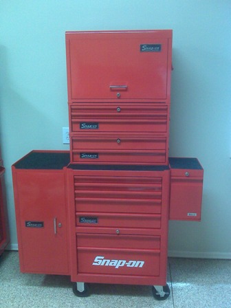

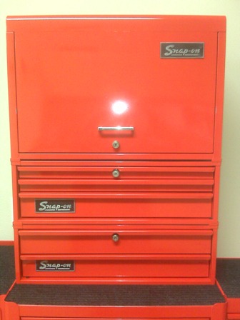

Just refinished boxes. Boxes and all drawers were sandblasted and powder coated inside and out. They look better to me now than when I purchased them in 1980. Cleaned and used original hardware. Soaked drawer slides in Evaporust, slides came out like new. Roll cab had small rust spot on bottom. After refinish, I braced inside bottom floor of roll cab with 1/8" thick aluminum plate and added 1/8" thick 1"x1" angled aluminum braces on top of aluminum plate, then thru bolted pieces together. Bolted on new 5x2 casters.
