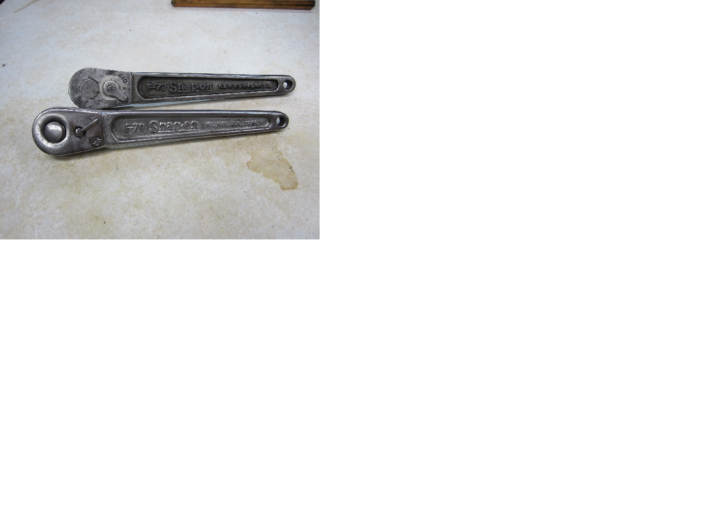

The F70 would be early 30s, two main types. the flat selector is hard to find.

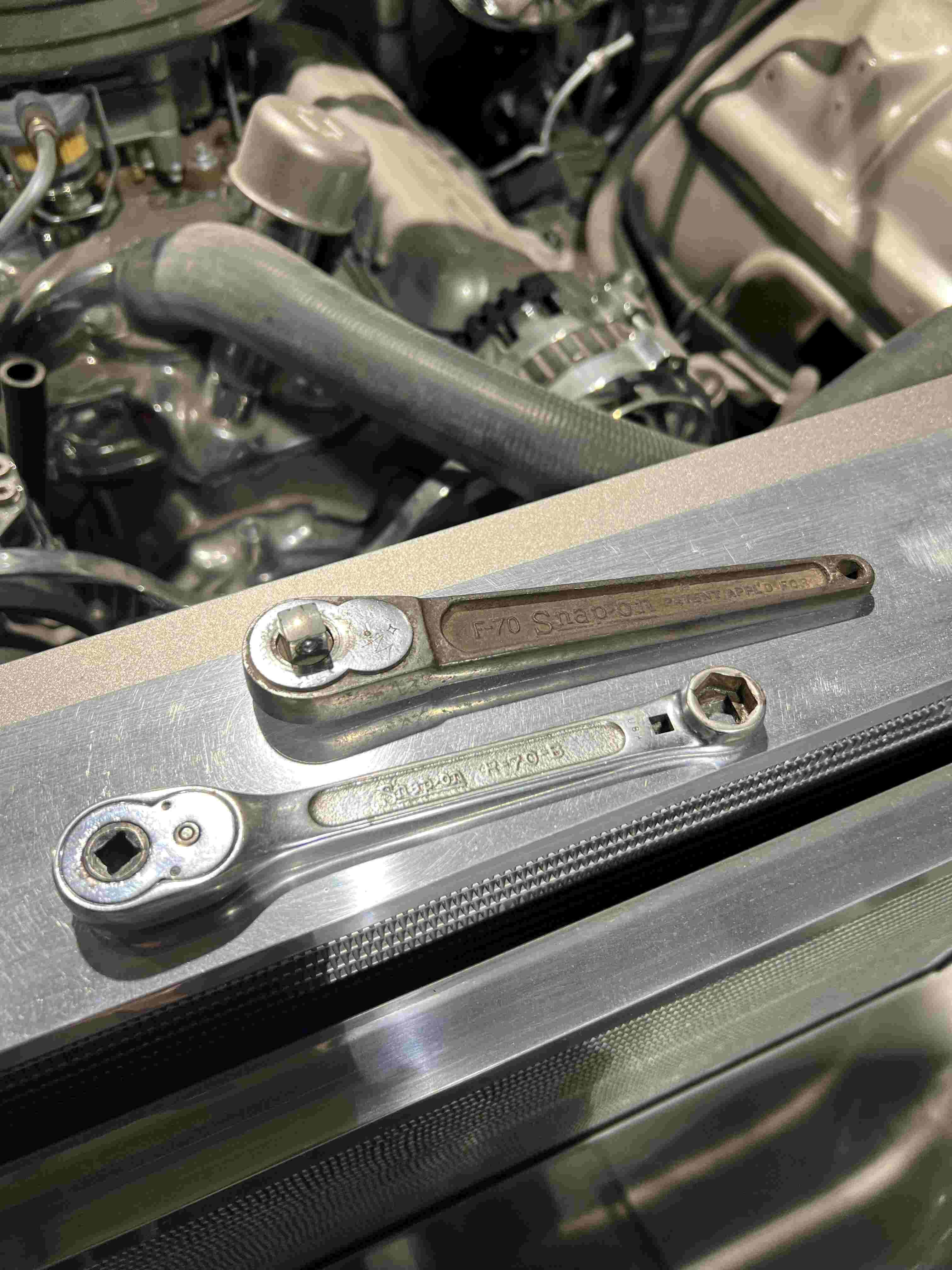

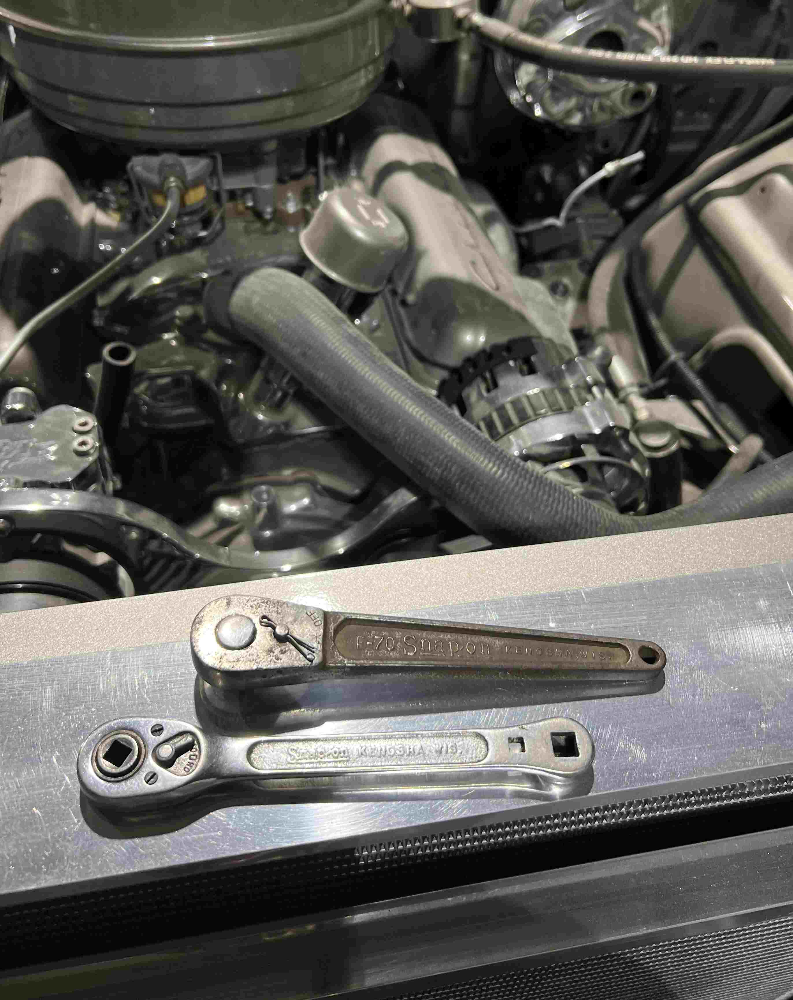

Thanks a lot 🫡🫡 so here’s pictures of my ratchet’s … I noted that my F70 has the same star as the flat one.. mine broke along its gurney… hey should I leave as is or try to find a re build kit ?

Sorry I had to resize the photos because file size was too large … here’s the ratchet’s
Re: R-70-B
you can take it apart and oil it. (use a plastic bag so you will not lose parts.) put it in a vise inside the bag, using a brass punch, tap the plate out from the rear. oil it replace the faceplate. will have to use a brass hammer, punch to reset the plate.
you can make a selector switch from a finishing nail.
