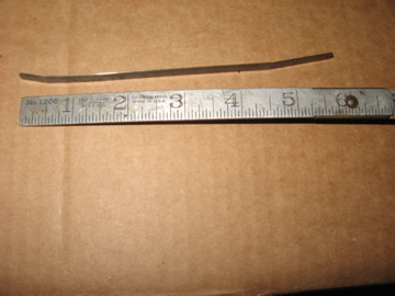

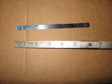

There is a tool. The tool looks like the picture
top View
top View
side view
side view
Snap on sells them ($15?)
You can make one, but a hack saw blade is too wide. It is also too thick. The spring that is used on the back of picture frames is about right. Some people have had success with a part of a tape measure.

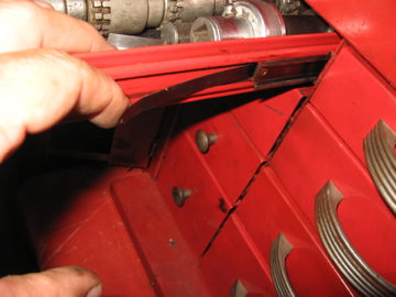

The slides are easy to get out – once you know how. There is a tab that you need to slide by. It is about ½ to 2/3 out on the inside between the drawer and the rail. Because the drawer is a part of the slide, you can also pull the drawer all the way out, then hold the black slide out, and push the drawer in, put in the tool, then push the black guide back to release one side. The 2nd side should be easier
drawer
drawer
The black slides bend. You can bend them back (carefully) or flip them over. I know of no source of replacement slides – be careful
