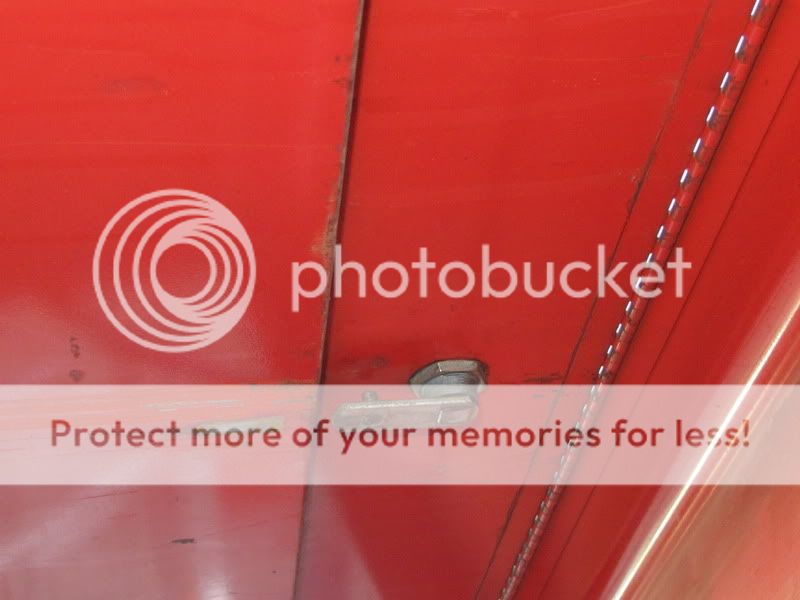

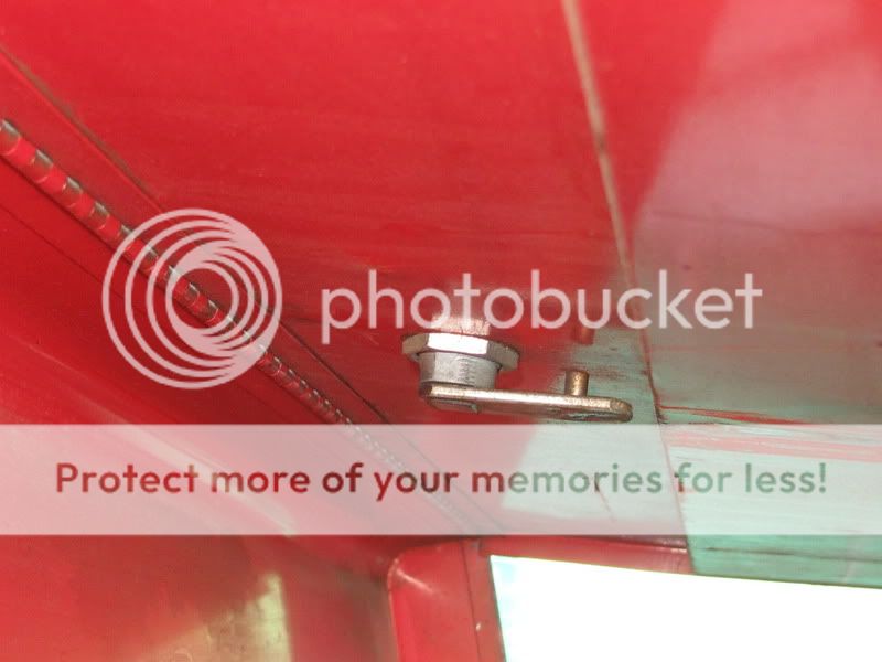

This is a lock on a KR-61 Supper Chest that I wish to remove and get re-keyed. The nut will not come off the lock housing because the cam bar is in the way. The bar appears to be crimped to the lock. How do I get this disassembled?

The nut should slip over the cam but it may be a bit of a dance. The hole in the nut is actually larger than the hole in the lid. But it may not be necessary to rekey the lock - a good locksmith should be able to impression a key for it. In fact that likely would be the better option since to get the cylinder out of the lock body the cam will have to be removed which means grinding the staking off.

The nut did slip over the cam nicely and then the lock assembly slipped out of the hole. I wasn't sure if it going to work that way or not.
