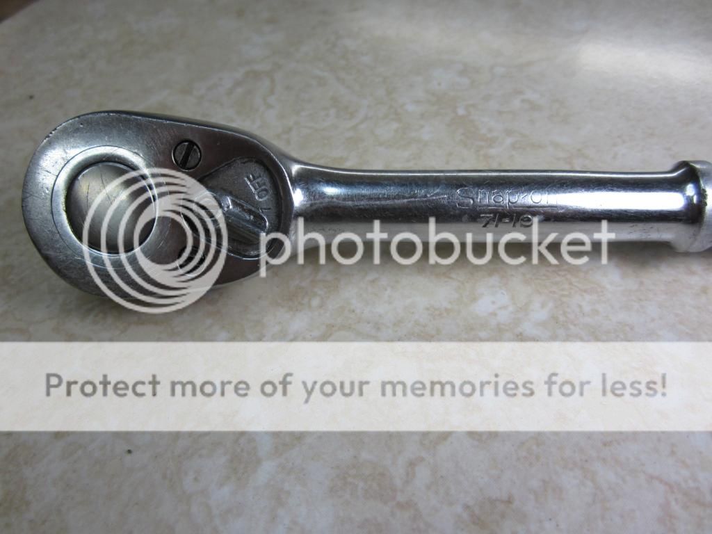

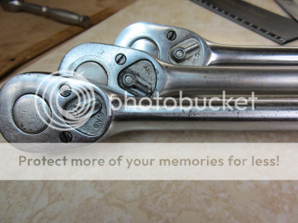

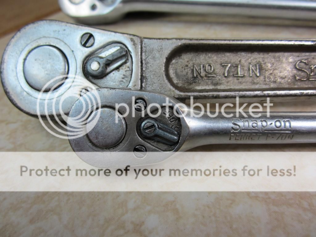

In about 1936 SO started to change the selector switch from the thin bar type to a flat type. In 36 some started to show up with a flat switch with a screw as the holder, then in 37 a pin was used as a holder to the flat switch. So if you are looking for a early version of the 71-15 or F70N from 36, just look for the screw. If you have a 71-10 or a 71A from 36 with a screw, please post a pic.
first pic. 71-15 36,37,38. second pic. 71A (37) and a F70N (36)

A 37 71-10 with a screw.
