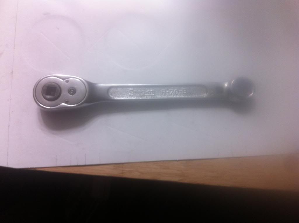

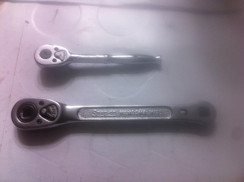

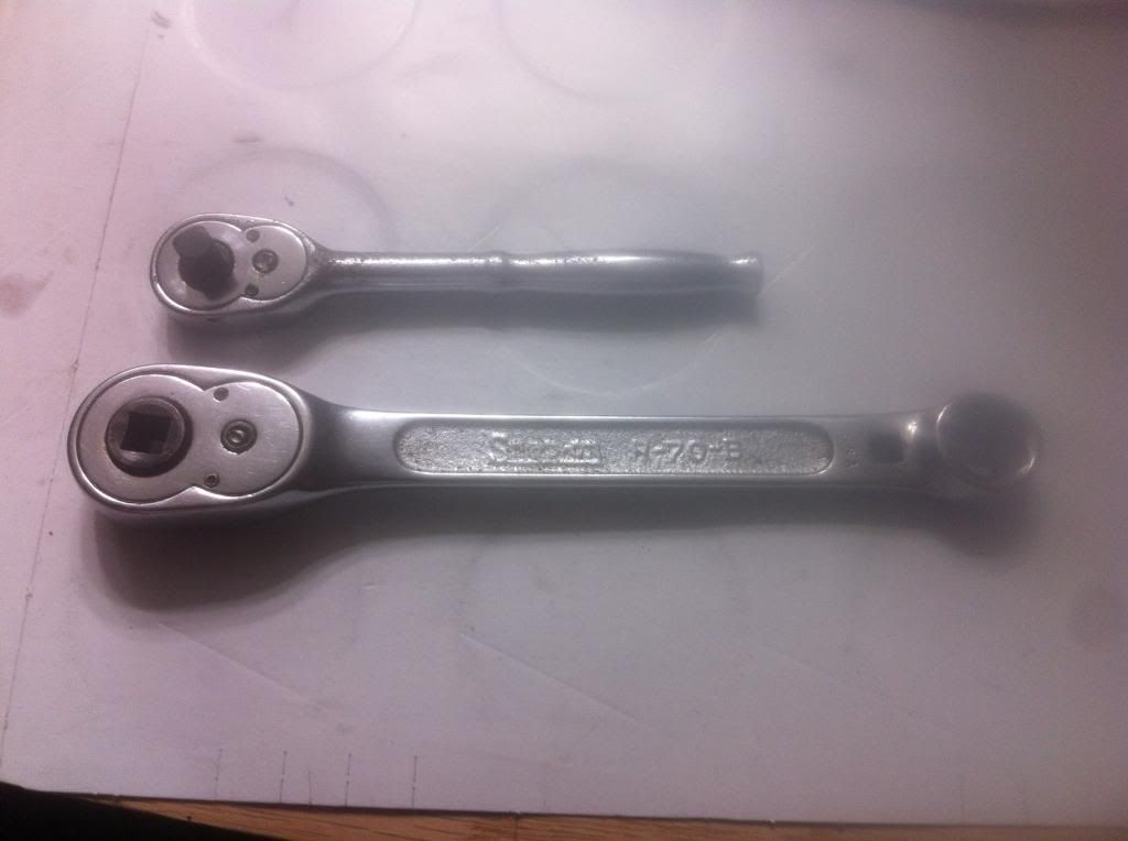

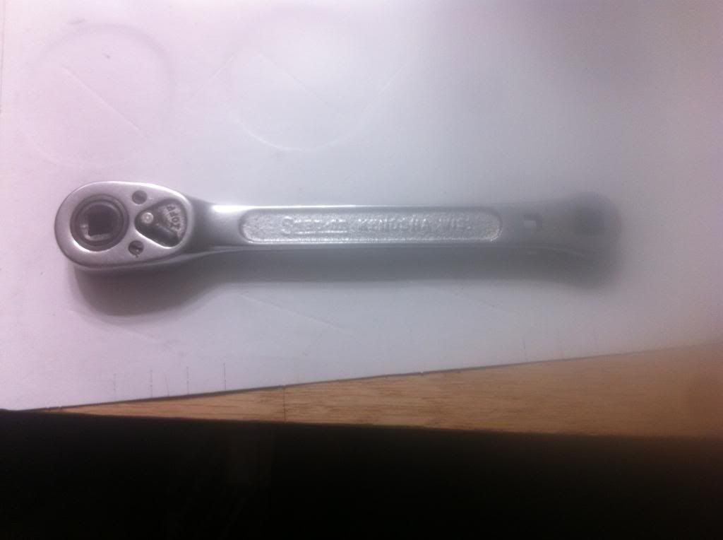

Hi I searched here and didn't see anything. What I wanted to know. Does anybody know if you can convert one of these to a normal ratchet? What kit would you use? Sorry for the bad pics.
Last two are pics of the R-70-B and a SM-70-M
Re: Snap-On R70-B
You would have to get a wheel from like a F70N and grind down the depth of the tooth section to fit. This is hard to do. Or you can find a 1/4 to 3/8 plug, but these are very hard to find.
