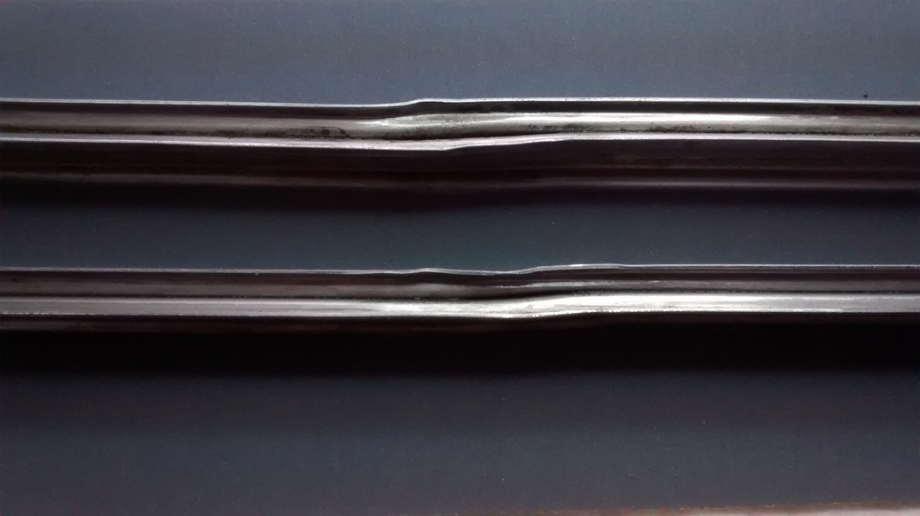

There are several slides with some damage. The attached photo shows two of the worst ones. Fortunately, I haven't found any damage on the welded rails on the drawers or inside the box.
- kra-300b_slides_sm.jpg (139.65 KiB) Viewed 7334 times

Last week, I called Snap-On customer service. Given the original part numbers for the slides, the woman on the phone was able to find the numbers for the superseding parts. I ordered one of each size just to make sure that they were indeed the correctly sized replacements. Got them today and it looks like they'll be a perfect fit. All the major dimensions match.
There is a slight difference in that the replacement slides have moved the spring steel catch in by about a 1/2" relative to the original design. This should simply limit the total drawer extension slightly, and I don't expect it to create a problem.
