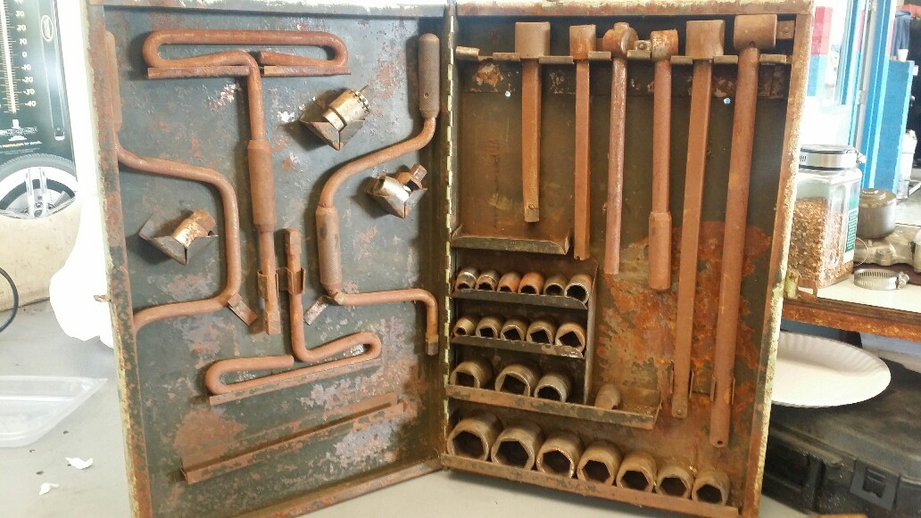

This set I picked up is pretty rusty. Should I clean it or is it better to leave as is. It's pretty old so I do not want to mess it up.
Re: Rusty tools 1925
Get a gallon of evapo-rust to clean the tools. Get 0000 steel wool, spray a small section of the box with pent. Oil and use the wool to remove the rust on that section, clean with paper towels, keep on going (sometimes on the same spot) till most rust is gone. (Do no do this to decals). Keep a thin coat of oil on the box, and tools.

I have some evaporust. Cool thank you.

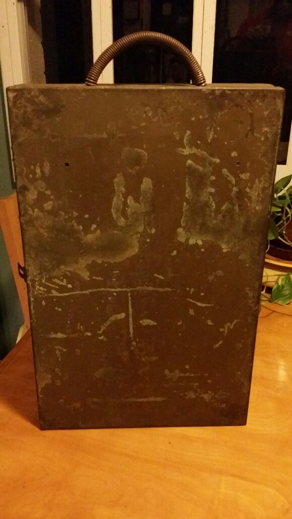

I suspect that is a common issue. The outside of this one is brush painted with house paint, so I suspect the original paint is still underneath. I will attempt to remove it with some paint thinner, but am not optimistic.
use lacquer thinner, (with gloves)

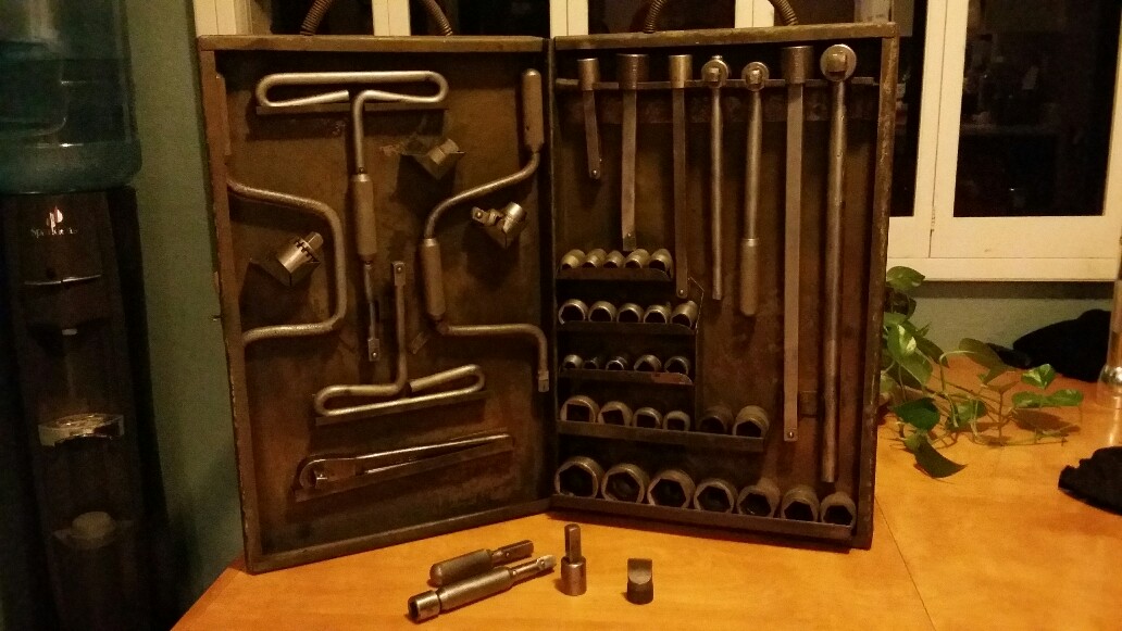

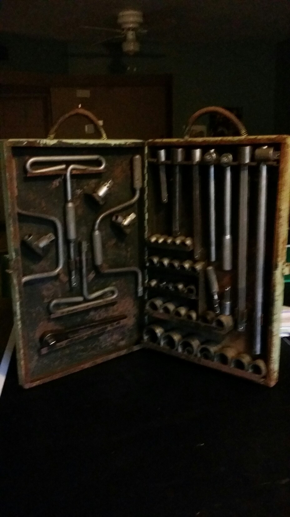

Evaporust worked pretty good. Will work on rust and paint on carry case next.

That looks great!

I have cleaned off the paint with some lacquer thinner with some success....
