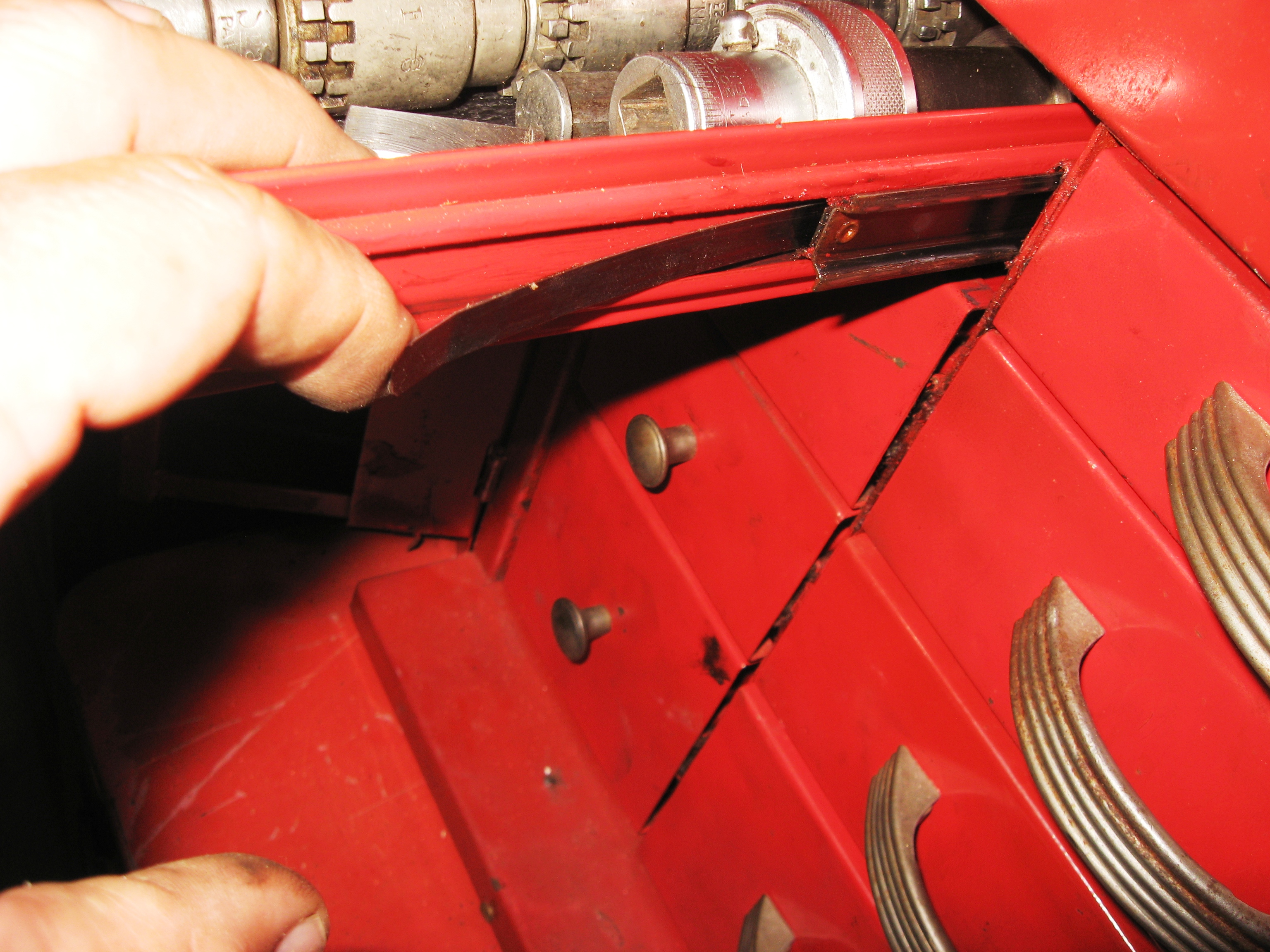

Where can I get the tool to remove the drawers? You need a narrow piece of spring steel, It slides into the side runner and allows the drawer to slide past a tab. Snap on has these ($15?). I will see if I can post a picture – You must find something thin, I bought the tool because I could not find anything thin enough, but one could create a work around tool.
In any case – that is what I know

- snapon9-2-11 025.jpg (2.25 MiB) Viewed 1498 times
