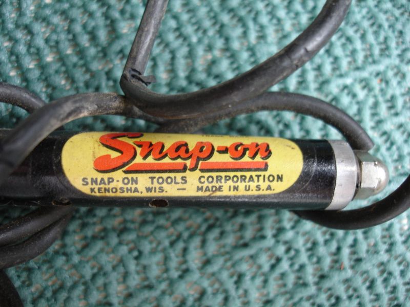

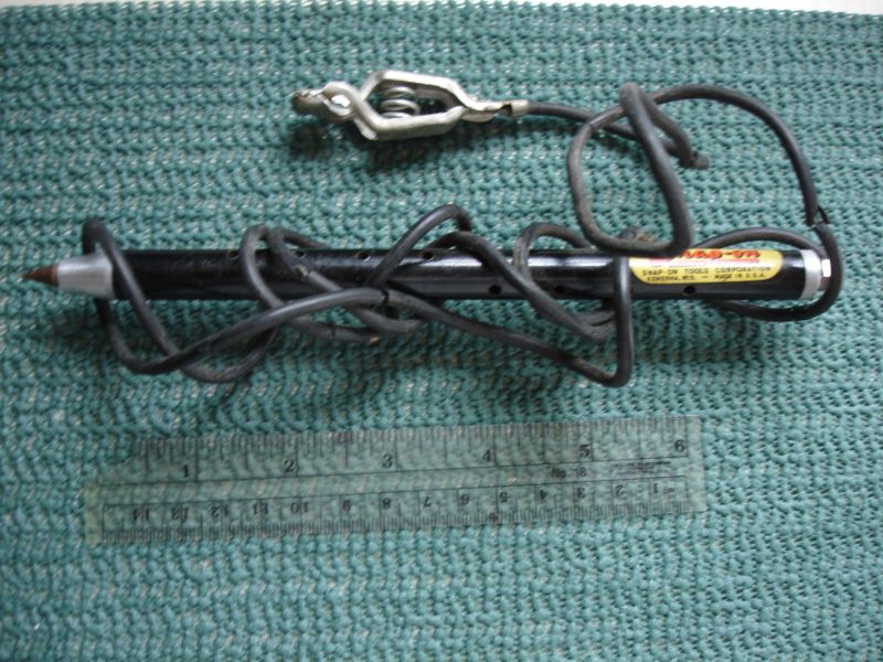

Found this cleaning out my garage preparing to move.Probably picked it up in my previous life as a sanitation engineer and kept it because I thought it unique.It has a spring loaded tip, box is original but label is not legible.
No date or model number, just the label that says Snap-on.I have looked through this forum and on eBay, found nothing similar.
Any ideas?
Any ideas?

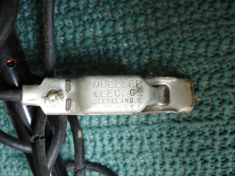

My guess would be 6V (because of its probable age) circuit/continuity tester. Does anything light up in the little holes on the barrel if you complete a circuit between the clip and the depressed tip? Of course, may not work given the poor condition of the cord.
This might be the same company. Shoot them an e-mail with a PIC of your tool attached. Maybe they'll be able to tell you about it.
http://www.muellerelectric.com/contact_information.html

Its an engraver.

It is for etching words,letters,numbers etc,into metal.The clip hooks to a 12 volt battery.then when you touch the tip to metal it will mark it.It is from mid 1970,s i think.In other words it allows you to write on metal.

It is one of three part numbers: GA-39, MT-330 or MT-331. It is an Etching Tool

Thanks for all the help, I found it at http://www.paddockclub.co.kr/snap/Insta ... /S7709.htm under part #MT330.No value yet.

I think it is a MT330 or MT-330 etching pencil from the late 1960s through the early 1980s
The other posibility is a GA-39, from the 1950s, but i think the shape is wrong for the older pencil
