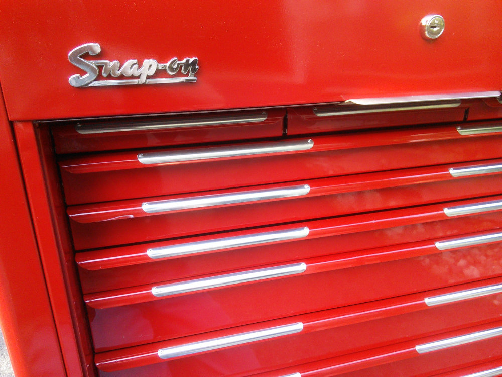

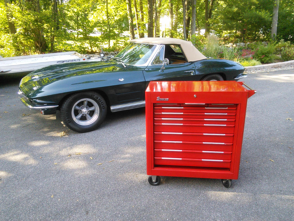

Here's a close up and the whole box.

Very nice indeed! Shows well with the Vette!
